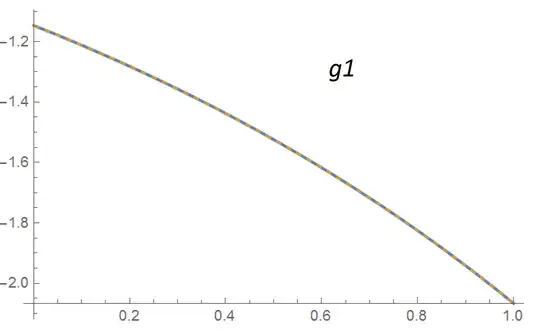

Here's a numerical check in Mathematica. For $n$ as small as $10$ we obtain a perfectly looking solution (the blue curve is the left hand side of the equation (1) and the orange dashed curve is the right hand side):
Nm = 10;
A = Table[N[1/(j + k + 1)/Sqrt[j! k!], 100], {j, 0, Nm}, {k, 0, Nm}];
{ln, Cn} = N[Eigensystem[A], 20];
g[n_, x_] := Sum[Cn[[n]][[j + 1]]/Sqrt[j!] x^j, {j, 0, Nm}];
Plot[{NIntegrate[Exp[x t] g[1, t], {t, 0, 1}], ln[[1]] g[1, x]}, {x,
  0, 1}, PlotStyle -> {Thick, Dashed}]

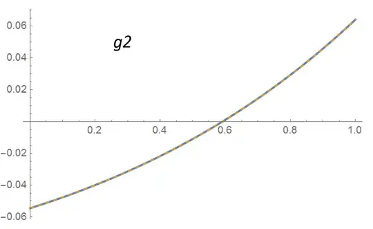

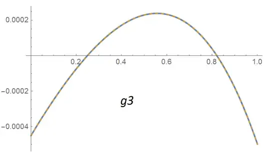

And two more eigenfunctions:
