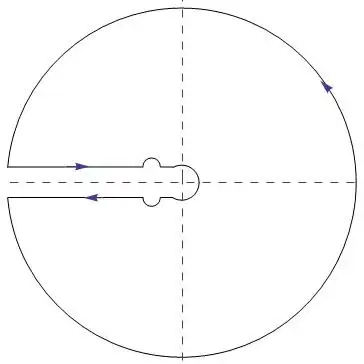

where $C_{\pm}$ is a keyhole contour about the positive/negative real axis, traversing the unit circle counterclockwise, with semicircular detours about the respective poles about $\pm (\sqrt{2}-1)$. (For a similar setup, see this answer.)
For example, $C_-$ is the following contour
crazy keyhole
which is a modified keyhole contour about the negative real axis within the unit circle. The modification is a pair of semicircular bumps of radius $\epsilon$ about the point $z=-1+\sqrt{2}$. These bumps are necessary because the integrand has a pole within the unit circle on the chosen branch cut of the integrand (i.e., the negative real axis).
I will leave the parametrization of the contour integral to the reader for the time being. Using the residue theorem, we determine that
