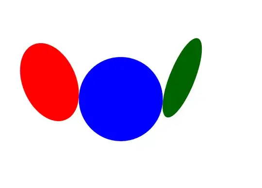

The entire 2-dimensional plane is covered by 3 sets: Blue, Green and Red. It is given that:
  • All sets are closed.
  • All sets are interior-disjoint (but may meet at their boundaries).
  • Blue is bounded.
  • Blue meets both Red and Green (i.e. their boundaries have non-empty intersection).
The following diagram illustrates the given facts (not the entire coloring):
I would like to prove that there is a point in which all 3 sets meet.
The intuition is that, if we start from the intersection of Blue and Green and move along the boundary of Blue, we must somewhere meet the Red boundary, since the entire plane is covered.
However, there are probably some cases in which this is not true. If this is so, what conditions do I need to add in order to make sure that the intuitive conclusion is true?
10
I think the result does not hold. Suppose Red is the closed unit disk (centered at the origin); blue is the closed annulus centered at the origin with inner radius $1$ and outer radius $2$ (so blue completely surrounds red); and green consists of all points at distance greater than or equal to $2$ from the origin.
