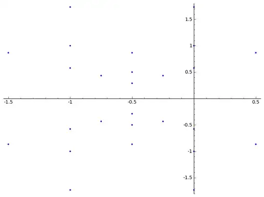

Here is where they lie in the complex plane:

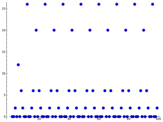

Here is a brief preview of the behavior of the function $f(n):=\#S_n$, as a plot of $f(n)$ for $n=2$ to $n=100$:
