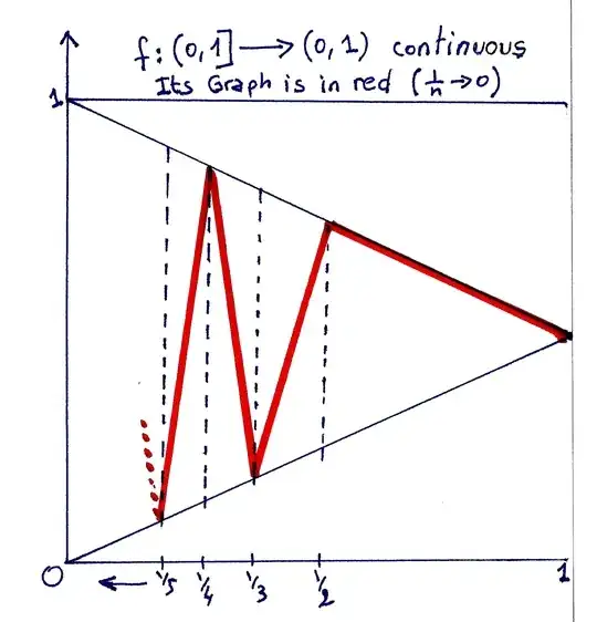

46
**Answer without words! see the figure **enter image description here
Idris Addou
  • 4,223
