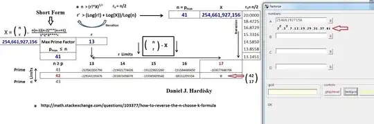

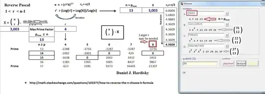

  • See my algorithm based on previous answer... and enter image description here D Hardisky –  Apr 24 '14 at 13:50
  • Forgive me, but this is a little difficult to read. Please would you provide some explanatory text? :) – Shaun Mar 03 '15 at 15:44
