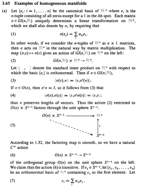

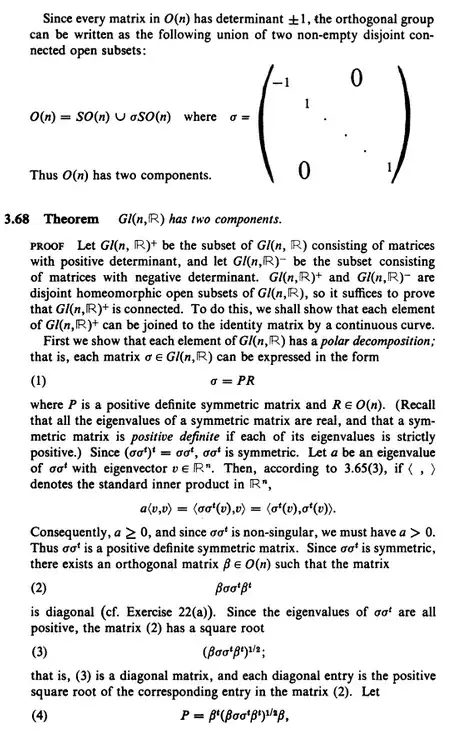

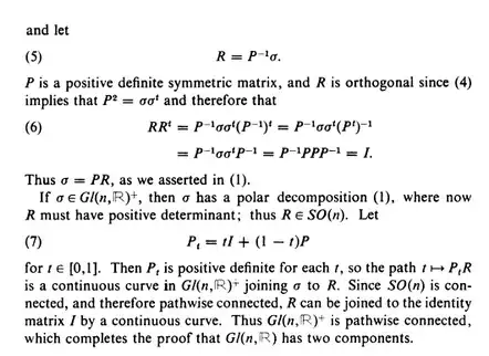

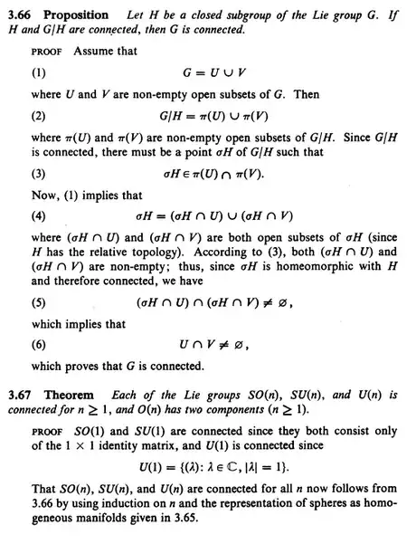

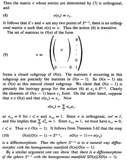

It is as you say: $Gl_n(\mathbb{R})$ has two components, $Gl_n(\mathbb{R})^+$ and $Gl_n(\mathbb{R})^-$. This is theorem 3.68, p.131 in Warner's "Foundations of differentiable Manifolds and Lie Groups". The preview in Google Books contains the relevant pages.
Well, I've added it for comfort:
enter image description here enter image description here enter image description here enter image description here enter image description here
