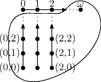

Let us consider the following example. Each arrow in the picture bellow represents a convergent sequence. I.e., this is a topological space homeomorphic to $\{0\}\cup\{\frac1n;n\in\mathbb N\}$ taken as a subspace of real line. Equivalently, this is precisely the ordinal $\omega+1$ taken with the order topology.
We take all these sequences and identify some of the points as in the picture. (I.e., we make a quotient space of some of these spaces.) Let us call the resulting space $S_2$. Then we take the subspace of this space as shown in the picture. This subspace will be called $S_2^-$. (I've taken the notation $S_2$ and $S_2^-$ from this paper: Franklin S.P., Rajagopalan M., On subsequential spaces, Topology Appl. 35 (1990), 1-19. But you can notice that this space is very very similar to Arens-Fort space mentioned in Brian's answer.)
Example
Now we want to show that $S_2^-$ is not pseudoradial.
Note that the space $S_2^-$ has only one non-isolated point. Let us call it $\omega$ . So we ask whether there is a transfinite sequence, consisting only of points different from $\omega$, which converges to $\omega$.
First, let us show that this is not possible for a regular cardinal $\alpha>\omega$. Suppose that $(x_\eta)_{\eta<\alpha}$ is an $\alpha$-sequence of points of $S_2^-\setminus\{\infty\}$, which converges to $\infty$. Let us denote $n_\eta$ the "column" to which $x_\eta$ belongs. In we use the notation the notation from the picture bellow $n_\eta$ is the first coordinate of ordered pair $x_\eta$.
We can see that $n_\eta$ converges to $\omega$. (E.g. by noticing that $(x,y)\mapsto x$ and $\omega\to\omega$ is a quotient map from $S_2^-$ to $\omega$ with order topology.)
Now this is not possible, since the we would be able to construct an increasing $\alpha$-sequence converging to $\omega$ and using this sequence we would be able to show that cofinality of $\alpha$ is $\omega$.
Example
So the only possibility is to take a sequence in the usual sense, i.e., a sequence of length $\omega$. Perhaps with a little handwaving, but it is more-or-less clear that general situation is similar to the situation when the $n$-term of the sequence is in the $n$-th column. So we have a sequence $x_n=(n,y_n)$. Obviously $\{\omega\}\cup\bigcup\limits_{n\in\omega} \{n\}\times(y_n,\infty)$ is a neighborhood of the point $\omega$ containing no terms of this sequence.
