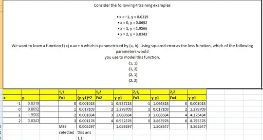

The calculated value for the above is given below.
One sample example. Consider the following 4 training examples
• x = −1, y = 0.0319 • x = 0, y = 0.8692 • x = 1, y = 1.9566 • x = 2, y = 3.0343
We want to learn a function f (x) = ax + b which is parametrized by (a, b). Using squared error as the loss function, which of the following parameters would you use to model this function. (1, 1) (1, 2) (2, 1) (2, 2)
