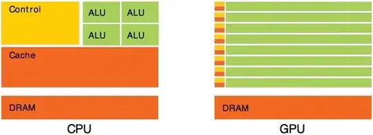

A trained model is just a well-defined set of floats i.e parameters
If we go for prediction,
What it will do are a large number of multiplication and addition of input data and the parameters. This will be done by the ALU (Both CPU and GPU)
A CPU will have a few ALU and a GPU will have thousands of them. So it will complete its task very quickly.
So, unless there is a difference of precision for holding the floats which might accumulate in a Deep Network, I don't see any reason that the prediction should differ.
