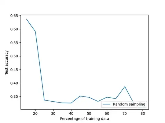

Now, the model performs well in the first 2-3 iterations and shows to learn on the validation set. However, in later iterations it completely stops learning and shows the same training and validation accuracy and loss. The test accuracy then always drops to the one of a random classifier (around 33%), as you can see here:
The test accuracy should increase instead, as the model is trained on a larger dataset. I really cannot understand why this happens. The code used in each iteration is exactly the same, and I always reset the weights before re-training. This is the code I use to reset the weights:
