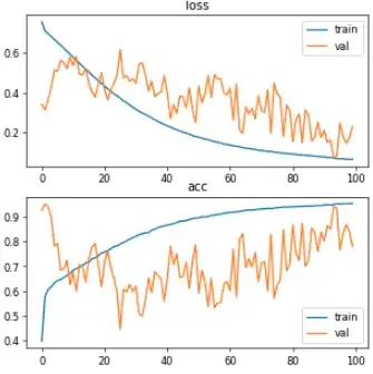

UPDATE
Thanks to the helpful answers and even more research, I think that the issue is in validation data (46 images) because the learning curves for 100 epochs, and learning rate 0.0001 are too noisy:
Training and validation accuracy and loss with lr = 0.0001

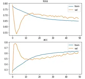

I tried to shuffle the data and decrease the learning rate to encounter the issue. Thus, I re-run the model with learning rate 0.00001 and 0.000001 but in smaller learning rates while the validation loss and accuracy were less noisy the validation IOU and dice coefficient stucked in 30% in all epochs.
Training and validation accuracy and loss with lr = 0.000001
It's worth to mention that I'm using early stopping callback with 'Accuracy' as a monitored parameter but 'Accuracy' is increased in all epochs, thus without early stopping. If I set any metric from validation the model stops in about 7 epochs without a useful result.

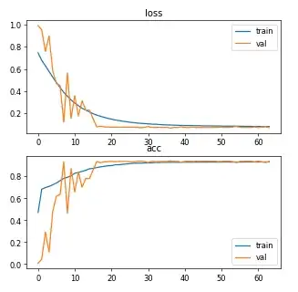

Update
After more research and experimentation, I think that one of the main issues that contaminate the results was the batch size. I increased the batch size in a level of 9 and decrease the input size from 512, 512 --> 256, 256 while I decreased the learning rate in a level of 0.001 also. As a result the validation curve fluctuation limited in the first epochs. Specifically, I re-run the model with the following parameters:
  • input size: 256, 256, 3
  • batch size: 9
  • train dataset size: 189
  • validation dataset size: 46
  • Learning rate: 0.001
  • epochs: 64 (stopped with early stopping)
And the final results was:
loss: 0.0813 - accuracy: 0.9320 - dice_coef: 0.9182 - iou_coef: 0.8532 - val_loss: 0.0719 - val_accuracy: 0.9365 - val_dice_coef: 0.9273 - val_iou_coef: 0.8696
Train and validation curves
But again when I display the original and the predicted image don't match each other as much as I expected based on the metrics from the final experiment.
Is still the model over-fitting ? Why is this happens ?

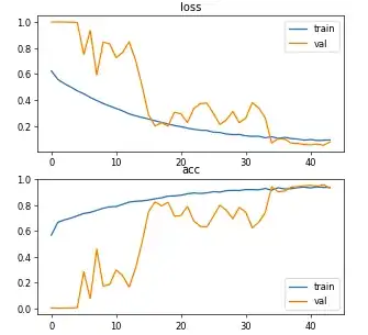

UPDATE
After the recommendation of @fswings, I re-splitted the data maintaining an equal number of classes in training and validation. My final dataset size was 125 images for training and 34 for validation. The other parameters are exactly the same with the last update above:
  • batch size: 9
  • train dataset size: 125
  • validation dataset size: 34
  • epochs: 44 (stopped with early stopping)
The metrics of the last epoch was: loss: 0.0969 - accuracy: 0.9350 - dice_coef: 0.9022 - iou_coef: 0.8279 - val_loss: 0.0818 - val_accuracy: 0.9299 - val_dice_coef: 0.9175 - val_iou_coef: 0.8537
which looks quite good but again the validation loss and accuracy curves are very noisy:
While the prediction results are quite worse from the last update above.
Any suggestion ?

The coefficients are reported on your 150 training examples? This looks like a textbook example of overfitting: good performance on training data, bad on test data. The U-net model has a large number of parameters that allow to fit your training data perfectly but it doesn't generalize to the examples the model hasn't seen yet.
You need to freeze all parameters of the model except the last couple of layers and see if that helps.

Update The plots show significant differences between the training and validation data. Having tried different sets of samples the result is the same.
Given that you have 4 classes, I would look closely at which of the 4 classes has the biggest difference. Given the relatively small sample size I suspect their is a class imbalance between the training and validation set. Ie the validation set is not representative of the training data. Formally this can be established when significant changes in training accuracy are not reflected in the validation accuracy.
One possible corrective action is to stratify the splitting of data. The second as a sanity check is to test with a single class or fewer classes.
