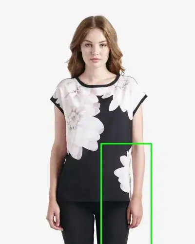

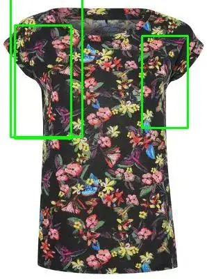

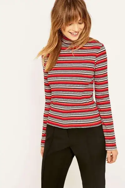

My problem is that this method, which seems like the currently best method to recognise humans in a picture according to literature (the original paper is dated 2005) seems to perform pretty poorly on my images. I have images containing clothes, both with a model and without it and I'm trying this approach to recognise those with the model. On a subset of 300 images which I manually scanned to tag them for containing the model or not, the method fails 30% of the times.
These are some images as examples.
Here it detected a missing human:
Here it did not get the full human:
Here it did not recognise it at all:
I understand that the detector works for upright humans. Should they also be full-figure? My images encompass half-figure, figures with no head or no feet.

You are using the training set that opencv is giving you which it doesn't correspond to the kind of images you are using. The data you are using comes from getDefaultPeopleDetector and the kind of images that the default detector uses are pictures of many people, not a female model from a fashion ecommerce.
If you want to distinguish between models and garments you can try to train your own classifier with HOG or other features.
Another path you can take is to detect if there is a face or not. You could use haar cascades for that.
