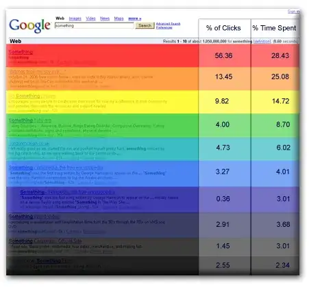

Users normally only view the first set of links, which means that unless the link is viewable, it's not getting clicks; meaning you'd have to be positive those are the best links, otherwise the clicks are most likely going to reflect placement, not relevance. For example, here's a click and attention distribution heat-map for Google search results:
Google SEPR Click and Attention distribution ‘heat-map’
Further, using click frequency to account for relevance is not a direct measure of the resource's relevance. Also, using clicks is problematic, since issues like click-inflation, click-fraud, etc. will pop-up and are hard to counter.
That said, if you're interested in using user interaction to model relevance, I would suggest you attempt to measure post-click engagement, not how users respond to search results; see "YouTube's head of engineering speaking about clicks vs engagement" for more information, though note that the size itself of the content is a factor too.
