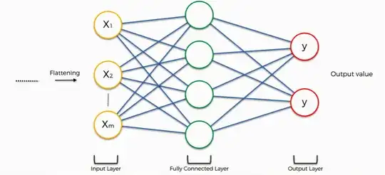

The input images contain a total of 784 (28 * 28) pixels, meaning that the model has 784 inputs. If we then use one node in the next layer which is connected to all inputs we also get 784 weights as each pixel is connected to the node in the next layer. See also the following image:
The input layer contains all the different inputs to our model (i.e. all pixels) and as you can see all those inputs are connected to all nodes in the next layer. Each connection/line has a specific weight assigned to it, the number of weights for a fully connected layer is equal to n_input * n_output. In the fast ai course this means that there are 784 weights (28 * 28 * 1), while in the example below there are 12 weights (3 * 4) for the first and second layer and 8 (4 * 2) for the second and third layer.
The reason for the bias already seems explained in the notebook itself, without the bias the function is not flexible enough. If all inputs are equal to zero the output would also be zero, whereas it needs to be a number different from zero. The bias allows for this by shifting the function up and down, see also the b term for a linear regression.
