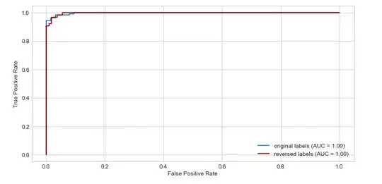

I made an experiment with a toy dataset in which first I trained a classifier with the original labels and plot the roc curve, then I switched the labels and train the same model on with the "new target" and even though the score in test set were the same, the roc auc plot looks slightly different.
import numpy as np
plt.style.use("seaborn-whitegrid")
from sklearn.datasets import load_breast_cancer from sklearn.preprocessing import StandardScaler from sklearn.linear_model import LogisticRegression from sklearn.model_selection import train_test_split from sklearn.metrics import roc_auc_score, plot_roc_curve
X, y = load_breast_cancer(return_X_y= True)
X_train, X_test, y_train, y_test = train_test_split(X, y, test_size = .3, random_state = 42)
model = LogisticRegression(class_weight= "balanced", max_iter= 10000, random_state = 42).fit(X_train, y_train)
fig, ax = plt.subplots(1,1,figsize = (10,5))
plot_roc_curve(model, X_test, y_test, ax = ax, name = "original labels")
Reverse the labels
y = np.where(y == 0,1,0)
Same partition train test
model = LogisticRegression(class_weight= "balanced", max_iter= 10000,random_state = 42).fit(X_train, y_train) cv_scores = cross_val_score(estimator= model, X = X_train, y = y_train, scoring= "accuracy")
plot_roc_curve(model, X_test, y_test, ax = ax, color = "darkred", name = "reversed labels");
