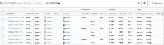

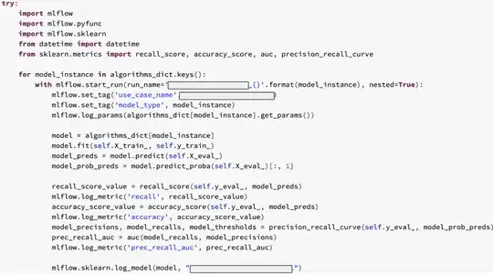

I am currently using MLflow together with Databricks at my company, and up to now, I would say it is quite ok for managing models versions, tracking models metrics and building the models workflow from a dev/experimenting/training status to production. I am not sure if it can be considered a standalone tool for that, meaning that you should combine it with something like Azure Databricks (what I currently use). It's nice the way you can customize the tags, metrics or artifacts that you might want to keep logged after each run or model training, as follows: enter image description here
where you can also visualize several run experiments as:

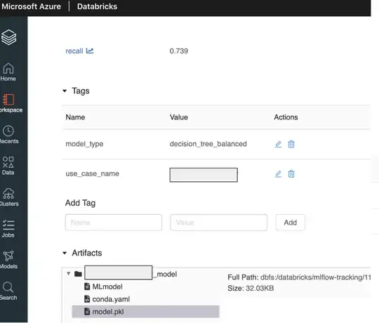

enter image description here (these models are for the shake of the example, so metric values are not optimized) and storing the generated models files (e.g. a pickle file) in the corresponding location: enter image description here

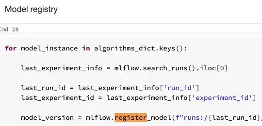

Once it is generated, you can register your best model via the databricks UI (in case you finally use it) or via mlflow code as follows (here I register the last one, you should take the one with the best prefered metric which mlflow also gives you directly as an option): enter image description here
