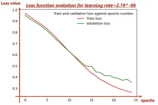

Loss function over 24 epochs with learning rate equal to 2.10^-6
The validation loss and training loss seem to decrease slowly. However, the validation loss isn't oscillating (it is almost always decreasing).

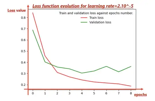

Loss function evolution over 8 epochs with learning rate equal to 2.10^-5
The validation and training losses decreased quickly on first 2/3 epochs. After 6 or 7 epochs, the validation loss increases again.

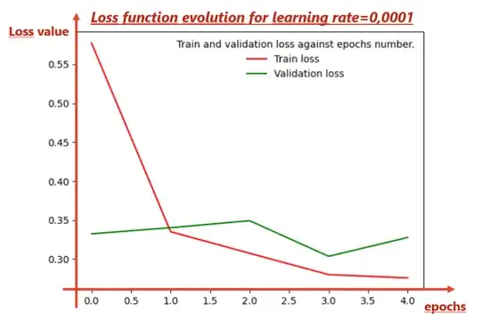

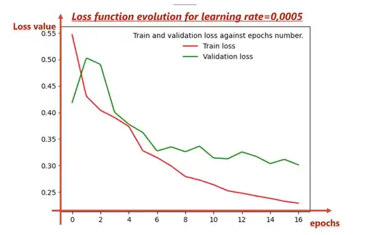

Loss function evolution over 4 epochs with learning rate equal to 1.10^-4 Loss function evolution over 16 epochs with learning rate equal to 5.10^-4
I have a few questions (I hope it is not too much):
  • *What is normally the best way to find the learning rate i.e.
    • How many epochs should I wait before considering that the learning rate isn't good?
    • What are the criteria on the loss function to determine if a learning rate is "good"?
  • Is there a big difference if I use a small learning (which still converges) instead of the "optimal" learning rate ?
  • Is it normal that the validation loss function oscillates over the training?
  • Which learning rate should I use according to my results?
Even a partial response would help me a lot.
