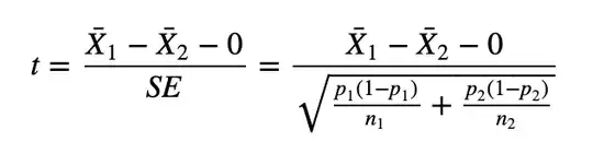

t-test for two populations:
Similar to the first question, we know the sample mean of each experiment is the CTR we need to compare. According to CTR, the sample mean is limiting normal distribution. Then we have
X¯1∼N(p1,p1(1−p1)/n1)
X¯2∼N(p2,p2(1−p2)/n2)
T-test:
If the click-through rate is not constant and is in fact randomly distributed (e.g. normal distributed), how does this affect the standard deviation of the sample mean CTR and consequently the validity of the test result.
My concern is that if use the above distribution and the actual standard deviation is higher we will end up accepting the alternative hypothesis incorrectly. Anecdotally, when we have run A/A tests (i.e. the variants are the same), we appear to often accept the alternative hypothesis more often than you would expect to and I want to find out whether this could be due to the assumptions around the click-through rate being constant.
