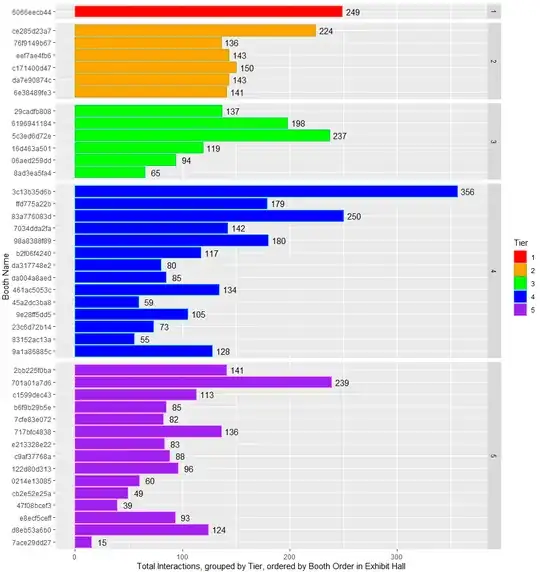

Today was the final day for an On Demand event I adminned. We got some data back from the provider today. Vendors bought in at different tiers, and only one T1 was allowed because they're a sponsor. The higher the Tier number, the fewer graphics options and later one's exhibit appears.
I applied a facet_grid to the data to separate by Tier. I'd like to add a trend line or at least three hlines (mean, mean ± stdev) to the graphic that sorts by position from the start of the exhibition hall to illustrate that the later the position, the less likely a vendor will be visited.
This code
Interactions %>%
    ggplot(mapping = aes(fill=Tier, color=Tier, x=reorder(`Booth Name`, -BoothOrder, max), y=`TotalInteractions`)) +
        scale_fill_manual(values=GraphColors) +
        geom_col() +
        geom_text(aes(label=TotalInteractions), color='black', nudge_y = 10) +
        facet_grid(Tier ~ ., scales = 'free_y', space = 'free_y', drop = T) +
        xlab(label = 'Booth Name') +
        ylab(label = 'Total Interactions, grouped by Tier, ordered by Booth Order in Exhibit Hall') +
        coord_flip()
begets this graphic (vendor names anonymized).
graphic , grouped by tier, ordered by static booth position
I'd like in each facet panel to show the mean and stdev and/or a trend line illustrating the likelihood of an attendee visiting a vendor which is at the end of the virtual exhibition hall. This would be comparable to a live event having someone off in a corner, furthest from the entrance or a main attraction.
Do I need to add more geom_somethings or facet differently?
Here's the redacted dput if anyone wants it.

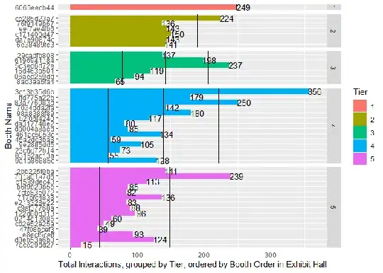

What you can do is creating another dataset with the mean and mean±stdev grouped by Tier. Then you can use that in geom_hline and ggplot will pick up facets from Tier. See below;
library(dplyr)
library(tidyr)
library(ggplot2)
Interactions %>%
  group_by(Tier) %>%
  summarise(mean = mean(TotalInteractions),
            `mean-stdev` = sum(mean(TotalInteractions), -sd(TotalInteractions), na.rm = T),
            `mean+stdev` = sum(mean(TotalInteractions), +sd(TotalInteractions), na.rm = T)) %>%
  pivot_longer(-Tier) -> Int_hline
Interactions %>%
  ggplot(aes(fill=Tier, color=Tier,
#  scale_fill_manual(values=GraphColors) + ## commented-out since we don't have GraphColors
  geom_col() +
  geom_hline(data = Int_hline, aes(yintercept = value)) +
  coord_flip()
Created on 2020-10-11 by the reprex package (v0.3.0)
