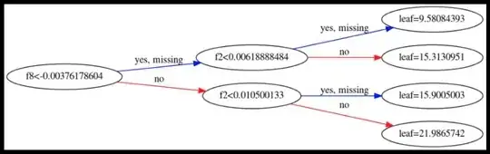

I've plotted the first tree in the ensemble:
# Plot single tree
plot_tree(ensemble, rankdir='LR')

  • Since there are four leaf nodes in the first tree, how come there is index 6 for the first training sample?

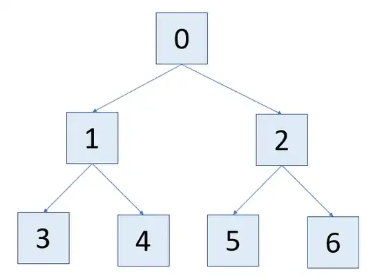

I think what you are seeing is the fact that all nodes in the tree are indexed because a priori the model doesn't know where splits will happen (i.e. any node could be a leaf). My guess is that the nodes follow an ordering similar to:
node ordering
In your case all of the leaf nodes are at the max depth of the tree, so nodes 3-6 show up in your list. By contrast, if your data was all the same value I would expect all labels to be node 0 (because the split criteria was not met). And then you could have intermediate situations where after 1 split there is a node which does not meet the split criteria (in this case you could see either node 1 or 2 show up in your list).
Hope this helps!
