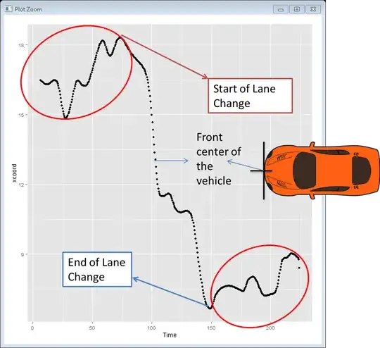

I have lateral positions, xcoord, of vehicles over time which were recorded as the distances from the right edge of the road. This can be seen for one vehicle in the following plot:
Each point on the plot represents the position of the front center of the vehicle. When the vehicle changes the lane (lane numbers not shown) there is a drastic change in the position as seen after the 'Start of Lane Change' on the plot.

I want to identify the start and end data points of a lane change by clustering the data as shown in the plot. The data points in the plot circled in red are more similar to each other because the variation between them is smaller compared to the data points in the middle which see large variation in position (xcoord).
My questions are: Is it possible to apply any clustering technique to segment these data so that I could identify the start and end point of a lane change? If yes, which technique would be most suitable?

I doubt any of the clustering algorithms will work well.
Instead, you should look into:
  • segmentation (yes, this is something different), specifically time series segmentation
  • change detection (as you said, there is a rather constant distribution first, then a change, then a rather constant distribution again
  • segment-wise regression may also work: try to find the best fit that is constant, linearly changing, and constant again. It's essentially four parameters to optimize in this restricted model: average before and after + beginning and end of transition.
