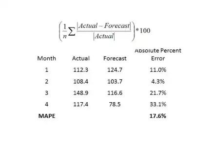

MAPE and MASE are common metrics to use for time series, which you may not be familiar with.
MAPE - Mean Absolute Percent Error:
MASE
MASE - Mean Absolute Scaled Error:
enter image description here Reference:
https://blogs.oracle.com/datascience/7-ways-time-series-forecasting-differs-from-machine-learning
You can consider also using multiple metrics for your assessment, not just one, as each metric has a slightly different purpose.
