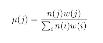

A straightforward calculation shows how to derive the desired mix of class i: μ(i) in terms of the calculated weight w(i) and number of examples in the training set (before any up or down sampling) n(i). This formula is given below:
Reference: https://medium.com/rv-data/how-to-do-cost-sensitive-learning-61848bf4f5e7

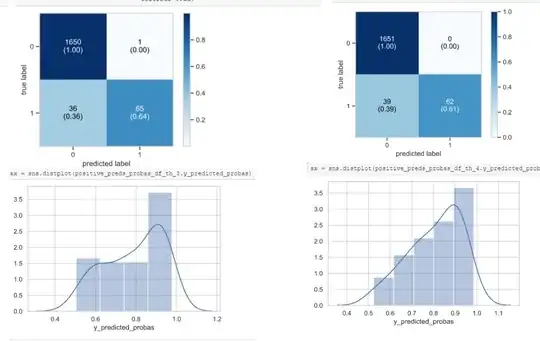

Supporting the second answer by Donald, I would also try to look at the predicted probabilities (via the predict_proba attribute in scikit learn classifiers) and customize your predictions by selecting the threshold (which you can check also in the corresponding ROC curve) which gives you the most robust (i.e. highest) predicted probabilities distributions, so your classifier is "sure" about what is predicting, something like: enter image description here here, the classifier on the right seems to give more robust predictions, although the confusion matrix on the right seems to be a little bit better).
You can also use metrics like recall, which gives a less optimistic and more realistic result (Recall is a metric that quantifies the number of correct positive predictions made out of all positive predictions that could have been made, source: https://machinelearningmastery.com/roc-curves-and-precision-recall-curves-for-imbalanced-classification/)
