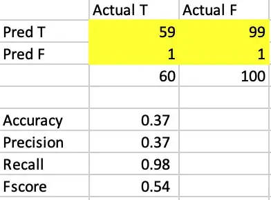

Imagine this case: you have actual labels of 60 true while 100 false; typically a model will more likely predict all false in my experience rather than the situation above, but in case where the machine predicts all to be true, then you can have fscore higher than accuracy.
