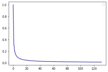

popt, pcov = curve_fit(func, df.index, df.Value,method='lm',maxfev = 8000)
t = np.linspace(0, len(df), len(df)) y0 = popt[0] params = (popt[1], popt[2], popt[3], popt[4]) # r, p, K, alpha sol = odeint(func, y0, t, args=params)
and this the plot:

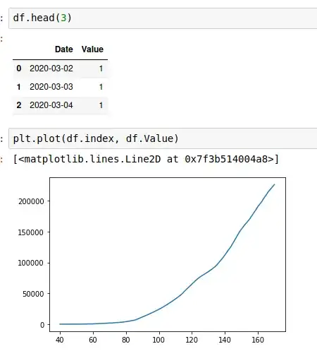

Note: this is how my real data looks like:
what I'm looking for it the best values for (r,p,K and alpha), how to find them?
