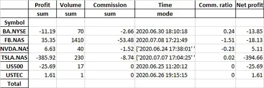

The output is:
output
As you can see it adds "sum" and "mode" rows that I'd like not to have.
Moreover, it ignores the df.loc['Total'] code and it leaves the Total row empty.

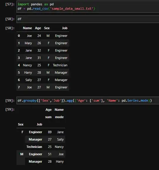

Example with most common value for column6 displayed:
df.groupby('Column1').agg({'Column3': ['sum'], 'Column4': ['sum'], 'Column5': ['sum'], 'Column6': pd.Series.mode})
Full example with code:

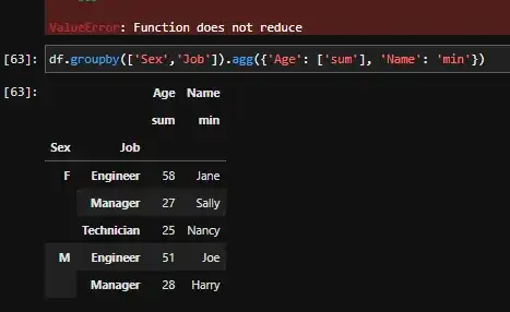

If there is a tie for most common, with one Mary and one Jane both being Female Engineers, this will generate an error as mode doesn't reduce to a single answer:
You will need to use another aggregate in that case, such as min, which will choose Jane as an alphanumeric min:

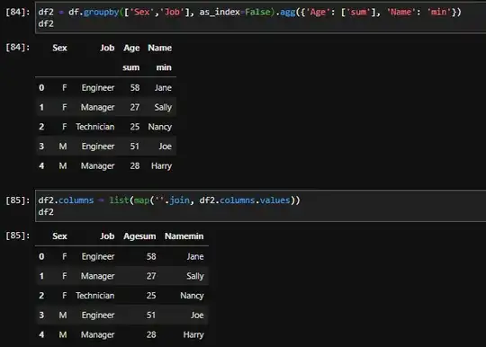

If you don't like the look of the multi-index, you can remove it using as_index=False and replacing the column names with a list(map(...join...))

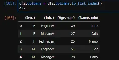

or remove it using to_flat_index() which gives a slightly different format for the columns:
