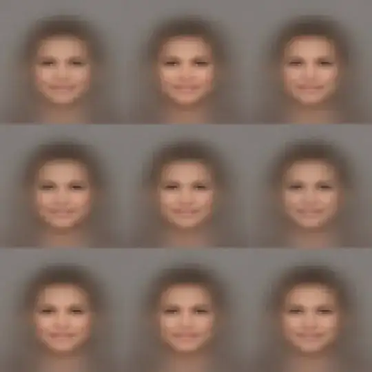

I'm training a variational autoencoder on CelebA dataset using TensorFlow.keras
The problem I'm facing is that the generated images are not diverse enough and look kinda bad.
(new) Example:
new image
What I think:
  • it's bad because the reconstruction and KL loss are unbalanced.
  • I read this question and followed its solution - read about KL annealing and tried to implement it myself but didn't work.
Note:
  • It's my first time working with autoencoders so maybe I missed something obvious.
  • it would be super appreciated if you could give a programmatic/technical solution and not a theoretical one with equations and complicated math

EDIT:
the latent size is 256 and the sample method is as follows;
def generate(self, image=None):
    if not os.path.exists(self.sample_dir):
        os.makedirs(self.sample_dir)
    if image is None:
        img = np.random.normal(size=(9, self.encoder_output_dim))
    prediction = self.decoder.predict(img)
    op = np.vstack((np.hstack((prediction[0], prediction[1], prediction[2])),
                    np.hstack((prediction[3], prediction[4], prediction[5])),
                    np.hstack((prediction[6], prediction[7], prediction[8]))))
    print(op.shape)
    op = cv2.resize(op, (self.input_size * 9, self.input_size * 9), interpolation=cv2.INTER_AREA)
    op = cv2.cvtColor(op, cv2.COLOR_BGR2RGB)
    cv2.imshow("generated", op)
    cv2.imwrite(self.sample_dir + "generated" + str(r(0, 9999)) + ".jpg", (op * 255).astype("uint8"))
else:
    img = cv2.imread(image, cv2.IMREAD_UNCHANGED)
    img = cv2.resize(img, (self.input_size, self.input_size), interpolation=cv2.INTER_AREA)
    img = img.astype("float32")
    img = img / 255
    prediction = self.autoencoder.predict(img.reshape(1, self.input_size, self.input_size, 3))
    img = cv2.resize(prediction[0][:, :, ::-1], (960, 960), interpolation=cv2.INTER_AREA)
    cv2.imshow("prediction", img)
    cv2.imwrite(self.sample_dir + "generated" + str(r(0, 9999)) + ".jpg", (img * 255).astype("uint8"))
The issue is in your sampling procedure. The purpose of a VAE is to train a neural network, the decoder, that takes samples $z$ from a normal distribution $p(z)$ and maps them to images $x$ such that the images follow the original image distribution $p(x)$. The encoder's job is essentially to facillitate the training of the decoder, but for sampling it is not needed.
What you do is that you sample an image with random pixel values, which has nothing to do with the original image distribution $p(x)$, and map it to the latent space. The encoder is trained to map images to the latent space, not noise, hence the encoding is way off.
Since the images with the normaly distributed values in the pixels are probably all similarly "wrong" compared to $p(x)$, they get mapped to a similar domain in the latent space and hence produce similar outputs.
For generation of new samples you only need the decoder, so instead of sampling images with normally distributed pixel values, sample normally distributed vectors in 256 dimensions and pass those through the decoder only.
