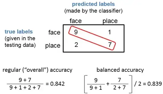

I've read plenty of online posts with clear explanations about the difference between accuracy and F1 score in a binary classification context. However, when I came across the concept of balanced accuracy, explained e.g. in the following image (source) or in this scikit-learn page, I was a bit puzzled as I was trying to compare it with F1 score.
I know that it is probably impossible to establish which is better between balanced accuracy and F1 score as it could be situation-dependent, but I would like to understand some pros/cons of the two performance metrics, as well as some applications in which one could be more suitable and useful than the other (especially in an imbalanced binary classification context).
