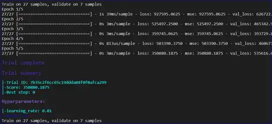

First of all you might want to know there is a "new" Keras tuner, which includes BayesianOptimization, so building an LSTM with keras and optimizing its hyperparams is completely a plug-in task with keras tuner :) You can find a recent answer I posted about tuning an LSTM for time series with keras tuner here
So, 2 points I would consider:
  • I would not loop only once over your dataset, it does not sound like enough times to find the right weights. I would rather control the number of possible hyperparams configurations as you said, which is something you can indicate in keras tuner via max_trials param
  • About using keras tuner with Bayesian tuner, you can find some code below as an example for tuning the units (nodes) in the hidden layers and the learning rate:

You would get something like this, informing you about the searched configurations and evaluation metrics:
