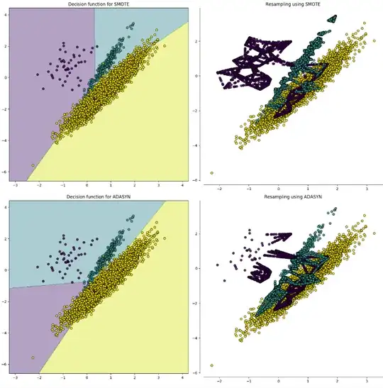

You could try another oversampling strategy, for example, SMOTE or ADASYN. These techniques create data points that are closets to decision boundaries so you are less inclined to overfit on "easy" data points.
smote and adasyn

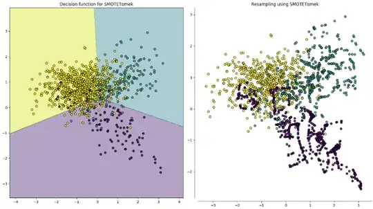

Another things you can try is oversampling the minority class and undersampling the majority class that the same time. When choosing a method to do this, pick one that can oversample near decision boundaries and undersample away from decision boundaries. For example, here is SMOTETomek. Notice how classes purple and green get mainly oversampled and class yellow mainly undersampled.
stometomek
These images come from imbalanced-learn which is a Python package you can use for all these sampling strategies.
