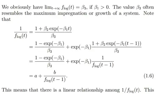

I am reading about time-series analysis in "A First Course on Time Series Analysis". The book reviews the logistic function ($f_{log}(t)$) (more on the special logistic function here and here).
Part 1.6 (PDF page 16; book page 8; screenshot below) explains how the inverse of the logistic function ($1/f_{log}(t)$) produces a linear relationship; so that "it can serve as a basis for estimating the parameters $β_1$, $β_2$, $β_3$ by an appropriate linear least squares approach"
I don't understand the last sentence:
This means that there is a linear relationship among $1/f_{log}(t)$.
mathematical proof showing how the inverse of logistic function has a linear relationship

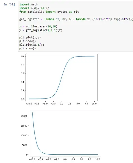

I specifically don't understand how the inverse of a logistic function, can produce a "linear relationship"; it doesn't look like a "straight line" when I graph it:
import math
import numpy as np
from matplotlib import pyplot as plt
get_logistic = lambda b1, b2, b3: lambda x: (b3/(1+b2np.exp(-b1x)))
x = np.linspace(-10,10) y = get_logistic(1,1,1)(x)
plt.plot(x,y) plt.show() plt.plot(x,1/y) plt.show()
two graphs, the first of a logsitic function, the second of the inverse of a logistic function

It's true, the function $1/f_{log}(t)$ is not linear, in other words there is not a linear relationship between $t$ and $1/f_{log}(t)$ but that's not what the author meant; the the important word is "among";
Note the end of the equations in the OP:
$$ \begin{aligned} \frac{1}{f_{log}(t)} &=... \\ \frac{1}{f_{log}(t)} &= a + \frac{b}{f_{log}(t-1)} \\ \end{aligned} $$
So there are relationship among the y values (the output of the function); specifically, there is a linear relationship between $1/f_{log}(t-1)$ and $1/f_{log}(t)$, where $a$ is the linear "y-intercept" and $b$ is the linear "slope".

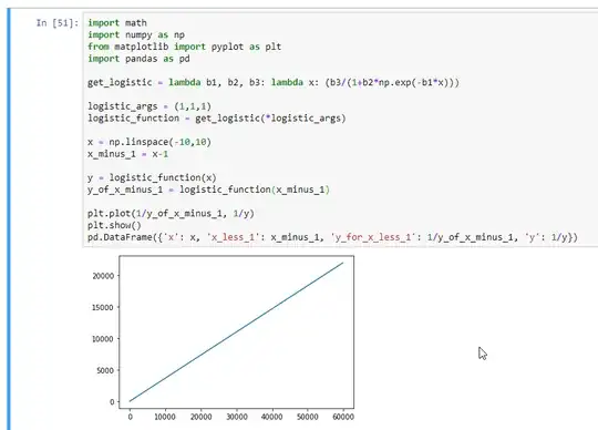

So we can change the code to plt.plot(1/y_of_x_minus_1, 1/y), and we will see a straight line:
import math
import numpy as np
import pandas as pd
logistic_args = (1,1,1) logistic_function = get_logistic(*logistic_args)
x = np.linspace(-10,10) x_minus_1 = x-1
y = logistic_function(x) y_of_x_minus_1 = logistic_function(x_minus_1)
plt.plot(1/y_of_x_minus_1, 1/y) plt.show() pd.DataFrame({'x': x, 'x_less_1': x_minus_1, 'y_for_x_less_1': 1/y_of_x_minus_1, 'y': 1/y})
Notice the straight line: linear_relationship_among_y_and_y_of_x_minus_1
