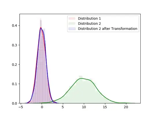

Here is a code in python that apply this transformation to two gaussian distributions
import seaborn as sns
import numpy as np
m1, m2 = 0, 10
s1, s2 = 1, 3
x1 = np.random.normal(m1,s1, 1000)
x2 = np.random.normal(m2,s2, 1000)
sns.distplot(x1, hist_kws=dict(alpha=0.1), color='red', label='Distribution 1')
sns.distplot(x2, hist_kws=dict(alpha=0.1), color='green', label='Distribution 2')
estimated_x1_mean = np.mean(x1)
estimated_x1_sd   = np.std(x1)
estimated_x2_mean = np.mean(x2)
estimated_x2_sd   = np.std(x2)
x2_new = (x2 - estimated_x2_mean + estimated_x1_mean)  * estimated_x1_sd / estimated_x2_sd
sns.distplot(x2_new, color='blue', hist_kws=dict(alpha=0.1, edgecolor='black'), label='Distribution 2 after Transformation')
plt.legend()
And the result enter image description here
