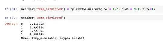

What about creating a Pandas DataFrame and adding a new column such as "Temp_simulated" and simulate the temperature?

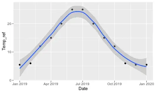

If you plot it using ggplot2 and passed the function geom_smooth, you can have a simulation of this data every day:
library(ggplot2)
ggplot(df_ref, aes(x = Date, y = Temp_ref))+
  geom_point()+
  geom_smooth()

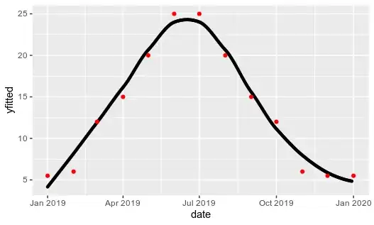

2) We can recreate this simulation by using loess function:
model <- loess(Temp_ref~as.numeric(Date), data = df_ref)
3) Now, we are using predict function to use this model to define temperature over the year for each day:
library(lubridate)
date <- seq(ymd('2019-01-01'),ymd('2019-12-30'),by='days')
df <- data.frame(date)
df$yfitted <- predict(model2, newdata = as.numeric(df$date))
4) We can confirm our fit by plotting it using ggplot2:
ggplot(df, aes(x = date, y = yfitted))+
  geom_point(size = 1)+
  geom_point(inherit.aes = FALSE, data = df_ref, aes(x = Date, y = Temp_ref), color = "red")
I'm not sure it is the perfect way to do it, but I think it gives you a good approximation of the evolution of the temperature over the year based on your reference vector.
Hope it helps you to figure it out the solution to your question.
