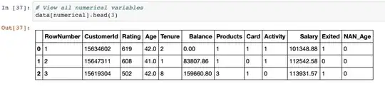

A trick I have seen on Kaggle.
Step 1: replace NAN with the mean or the median. The mean, if the data is normally distributed, otherwise the median.
In my case, I have NANs in Age.
Step 2: Add a new column "NAN_Age." 1 for NAN, 0 otherwise. If there's a pattern in NAN, you help the algorithm catch it. A nice bonus is that this strategy doesn't care if it's MAR or MNAR (see above).
