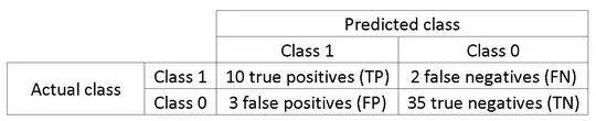

To get the confusion matrix, we go over all the predictions made by the model, and count how many times each of those 4 types of outcomes occur:
In this example of a confusion matrix, among the 50 data points that are classified, 45 are correctly classified and the 5 are misclassified.

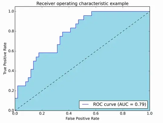

To combine the FPR and the TPR into one single metric, we first compute the two former metrics with many different threshold (for example $0.00; 0.01, 0.02, \dots, 1.00$) for the logistic regression, then plot them on a single graph, with the FPR values on the abscissa and the TPR values on the ordinate. The resulting curve is called ROC curve, and the metric we consider is the AUC of this curve, which we call AUROC.
The following figure shows the AUROC graphically:
In this figure, the blue area corresponds to the Area Under the curve of the Receiver Operating Characteristic (AUROC). The dashed line in the diagonal we present the ROC curve of a random predictor: it has an AUROC of 0.5. The random predictor is commonly used as a baseline to see whether the model is useful.

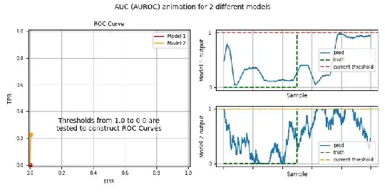

From this post:
This is an animation about the construction of the ROC Curve and so the AUC. One sees clearly that each point of the ROC Curve comes from a different threshold used to classify the output of a binary classifier. The threshold defines which samples are predicted as 1 and which ones as 0. True Positive and False Positive rates are then computed. At every threshold corresponds a point on the ROC Curve.
roc_auc_construction
Note: The animation might be more relevant for people working on time-series, but could also help to understand the AUC construction in other cases as a Sample, the input of the binary classifier, could be anything (image, time-serie window, input features,...)
