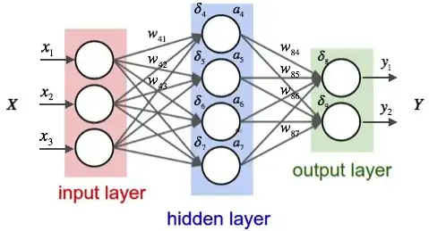

Here is a small Neural Network (image link): enter image description here
So, there are 12 weights between the input layer and the hidden layer. If you change input size from 3 to 4, the number of weights between input layer and hidden layer will increase to 16.
So, when your input samples are different, the number of weights in your model are also different. But, training Neural Network simple means updating weights. Then, how you would update your weights if every input sample generates different number of weights?
Same logic applies to Convolutional Neural Network.
