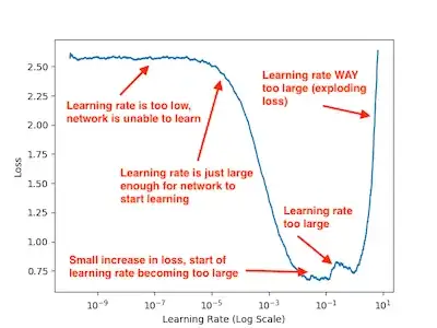

Finding an optimal learning rate is an important step in optimizing a neural network. As discussed at length here it is not a trivial question, but there are some ways to get a good starting value. Main idea here is to plot loss vs learning rate for different values and choose the learning rate where the slope is the highest:
This image is from the link above. This figure tells me that anything from a little right of 10-5 to around 10-3 can be a good learning rate. One can also set a relatively high learning rate, and reduce it when the loss function reaches a plateau, so in the above example, you would be better off by starting with the highest end; and lower the rate later as needed. This can be achieved by a learning rate scheduler (such as the one in Keras callbacks). This way, you won't spend a lot of time at the initial epochs where there is a lot to learn and the loss drops quickly. Three key parameters of a scheduler are "factor","patience" and "min delta" . If the loss function does not change by "min delta" in "patience" number of epochs, the learning rate is reduced by the ratio defined in "factor".
