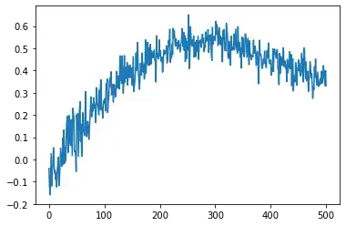

I have trained an RL agent using DQN algorithm. After 20000 episodes my rewards are converged. Now when I test this agent, the agent is always taking the same action , irrespective of state. I find this very weird. Can someone help me with this. Is there a reason, anyone can think of why is the agent behaving this way?
Reward plot

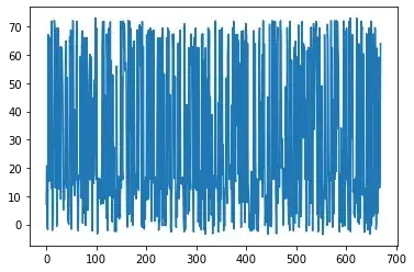

When I test the agent
state = env.reset()
print('State: ', state)
state_encod = np.reshape(state, [1, state_size])
q_values = model.predict(state_encod)
action_key = np.argmax(q_values)
print(action_key)
print(index_to_action_mapping[action_key])
print(q_values[0][0])
print(q_values[0][action_key])
q_values_plotting = []
for i in range(0,action_size):
    q_values_plotting.append(q_values[0][i])
plt.plot(np.arange(0,action_size),q_values_plotting)
Every time it gives the same q_values plot, even though state initialized is different every time.Below is the q_Value plot.

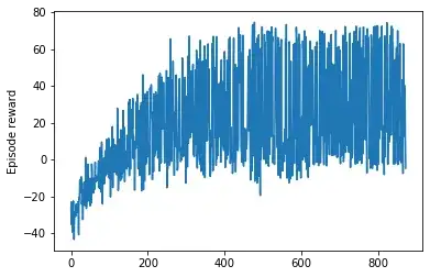

Testing:
code
test_rewards = []
for episode in range(1000):
    terminal_state = False
    state = env.reset()
    episode_reward = 0
    while terminal_state == False:
        action = index_to_action_mapping[action_key]
        print('Action: ', action)
        next_state, reward, terminal_state = env.step(state, action)
        print('Next_state: ', next_state)
        print('Reward: ', reward)
        print('Terminal_state: ', terminal_state, '\n')
        print('----------------------------')
        episode_reward += reward
        state = deepcopy(next_state)
    print('Episode Reward' + str(episode_reward))
    test_rewards.append(episode_reward)
plt.plot(test_rewards)
