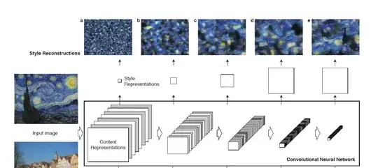

Gram matrix is just a way to theoretically represent style. In the NST paper, the authors defined style as the correlation between different features of a certain layer, where the layer position (i.e. a deeper layer or a shallower layer)
determines the local scale on which the style is matched.
They mentioned that (they found that)
matching the styles up to higher layers in the network preserves local images structure... leading to a smoother and more continuous visual experience.
So the idea here is to take the style of different scales from the style-image and blend it with the generated (originally white-noise) image.

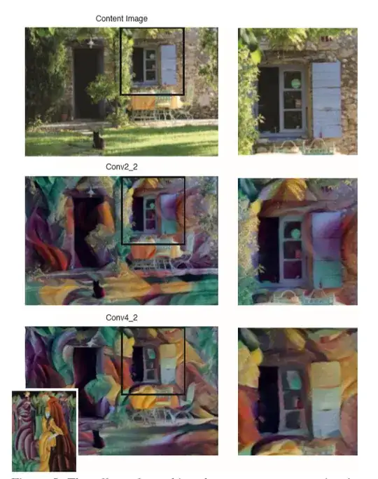

They tried different layers and eventually took the Conv4 layer. They also tried taking the content layer from Conv2 - but the results are shown in figure 5,
When matching the content on a lower layer of the network, the algorithm matches [too] much of the detailed pixel information in the photograph and the generated image appears as if the texture of the artwork is merely blended over the photograph
