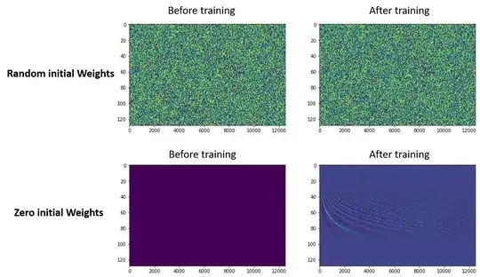

What I discovered
If the initial weights are random, the network seems unable to learn any meaningful weights. But when we set the initial weights to zero, the network can learn something meaningful.
Why is it so? I don't understand why only zero weights works in this model. enter image description here

Let's think of
as a minimum on the manifold along which the optimizer moves the state of the system until the state descents into the same minimum.
If you do a random initialization you throw the system into a random state on the manifold. But what if you had knowledge of a particular part of the manifold from which you know a direction to push towards (loss) to descent into that minimum. I believe that in your case the zero state of the weights is some fixpoint in the output space from which the optimization is eased with your choice of loss.
Theoretically, if you could define a path for the optimizer through the loss function, you could reach it as well, but it unlikely that you can accurately express it.
