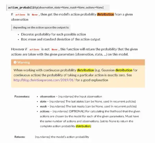

Update: I found this on the Stable baselines site for PPO:
return probability distribution
From this URI: ppo explanation

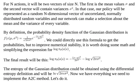

Packt Publishing's "Deep Reinforcement Learning Hands-On" has an entire chapter on continuous action spaces. Here is the math in the book:
math for continuous action space
and the code accompanying the book: code repo for book
The code for the math above is in:
The complete source code is in Chapter14/02_train_a2c.py , Chapter14/lib/model.py and Chapter14/lib/common.py . Most of the code will already be familiar to you, so the following includes only the parts that differ. Let's start with the model class defined in Chapter14/lib/model.py .
