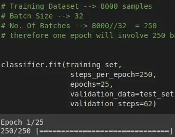

Let's clear it :
Assume you have a dataset with 8000 samples (rows of data) and you choose a batch_size = 32 and epochs = 25
This means that the dataset will be divided into (8000/32) = 250 batches, having 32 samples/rows in each batch. The model weights will be updated after each batch.
one epoch will train 250 batches or 250 updations to the model.
here steps_per_epoch = no.of batches
With 50 epochs, the model will pass through the whole dataset 50 times.
