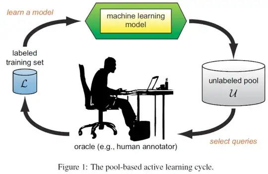

Your flow is correct. Model is retrained on new labeled data. Otherwise, the next candidates for labeling will be selected from the same region as previous candidates on which the model is least certain. By training on new labeled data, model will move on to new regions about which is least certain. Here is the diagram for pool-based method from page 5 of this survey on active learning:
