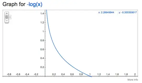

Consider this equation as being made up of two separate functions:
  1. $-log(\hat{y_i})$
  2. $log(1-\hat{y_i})$
Consider two classes. $y = 1$ and $y = 0$. Now the first function looks like this: enter image description here
This is the loss function (and by loss function means I am analysing over one single example) for y = 1. Simply put, this means the loss is zero if you predict y = 1 when it is actually one and the loss is INFINITY if otherwise (if you predict y = 0 when y = 1). In the latter case, you are heavily penalising your loss function for extremely wrong predictions.

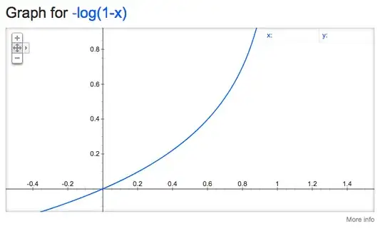

On the other hand, the second function is loss function for y = 0: enter image description here
Using similar reasoning, you can get an intuition that this function is being heavily penalised when it predicts y = 1 (and the actual label is y = 0). And vice-versa is true as well.
