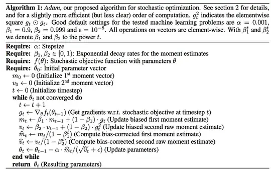

EDIT: to clear a misunderstanding brought up in an answer, learning rate and step size are synonymous. See the algorithm definition in the Adam paper: $\alpha$, whose default value is 0.001, is clearly named the step size. I reckon it's probably not a great name (the actual size of the step in the parameter space depends on the accumulated first order and second order momentums, as well as on the gradient, of course) but unfortunately such misleading terminology is the norm in optimization (at least in Deep Learning papers).

Actually as mentioned by OP, the learning rate and step size are the same thing (my bad, I confused it with the batch size).
