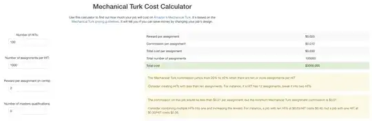

I was first looking at Mechanical Turk, where you can hire people to label each article manually for you. And this may be the best way forward but expensive. enter image description here

  4. Mechanical Turk would be a good option if you can limit the number of samples sent for classification. For each language, you could try clustering the passages by, for example, word count into 30 (you pick) clusters and then perform sampling within the clusters to identify candidate passages to send to Mechanical Turk. I have used this technique to try to sample across the vector space more uniformly.
