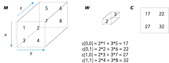

Edit: Simple example
I am going to show you a simple example of the operations that occur during the deep convolution between M, a tensor of dimension (z= 2, x=2, y=2), where you can see z as your k that you want to shrink to 1 and W, a filter of dimension (2, 1, 1). You will have to implement your own function with a loop to operate the stride of the filter.
import numpy as np
M = np.array([[[1, 2],[3, 4]], [[5, 6],[7, 8]]])
W = np.array([[[2.]],[[3.]]])
C = np.ones(shape=(2, 2))
c[0,0] = np.sum(M[:, 0, 0]*w.T)
c[0,1] = np.sum(M[:, 0, 1]*w.T)
c[1,0] = np.sum(M[:, 1, 0]*w.T)
c[1,1] = np.sum(M[:, 1, 1]*w.T)
