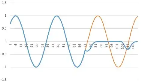

When inspecting the ability of the network to predict the continuation of a sine wave (comparing y[0,:,0] to pred[0,:,0] for example, in order to compare the first sine wave of the first generated datum), see that my network performed very badly:
The predicted vs actual 50 last points in a sample sine wave, placed after the part of the wave used as input for the NN
(Edit: legend: The predicted vs actual 50 last points in a sample sine wave (blue and orange, respectively), placed after the part of the wave used as input for the NN)
What did I do wrong? And how should I my code to correctly track sine waves? Many thanks!

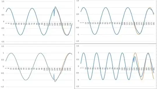

I have added a dense layer to the network:
model = Sequential()
model.add(LSTM(32, return_sequences=True, input_shape=(None, 5)))
model.add(Dropout(0.2))
model.add(LSTM(32, return_sequences=True))
model.add(TimeDistributed(Dense(5)))  # <--- This is new :)
model.add(Activation('linear'))
model.add(Lambda(lambda x: x[:, -50:, :])) # Grab only the last 50 values
This has provided some improvement :
These are two sine waves and the predictions of the last 50 data points of them. As can be seen, the results have improved, with some of them being okay approximations of the sine waves. Other times... not so much.
Still a lot better than the previous results.
