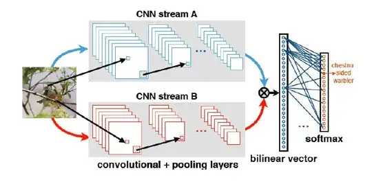

Bilinear Models consists of two feature extractors whose outputs are multiplied using an outer product at each location of the image and pooled to obtain an image descriptor. 1
Its advantage is that it can model pairwise feature interactions in a translationally invariant manner, which is particularly useful for fine-grained categorization. It also allows end-to-end training using image labels only, and achieves state-of-the-art performance on fine-grained classification.
